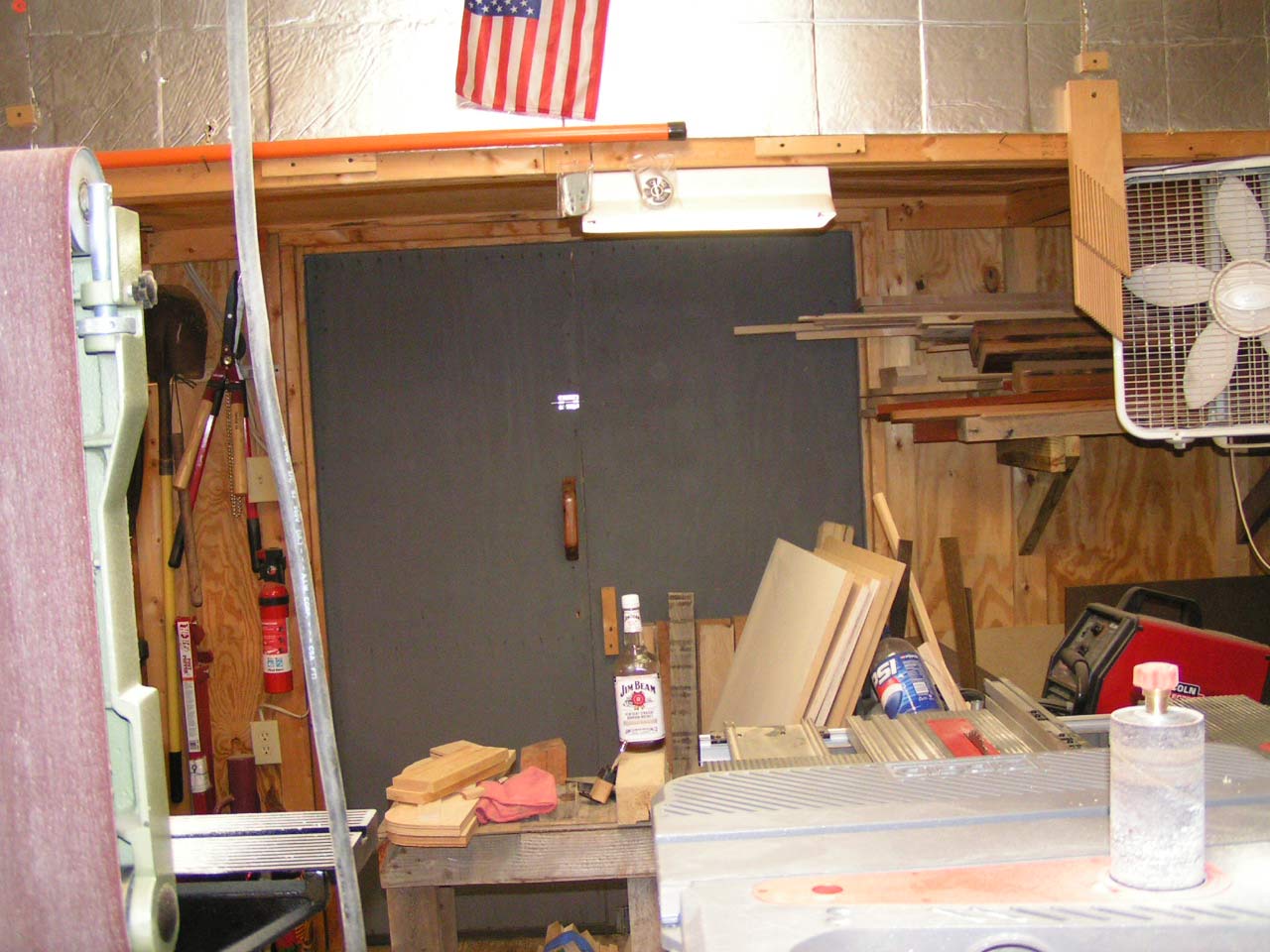

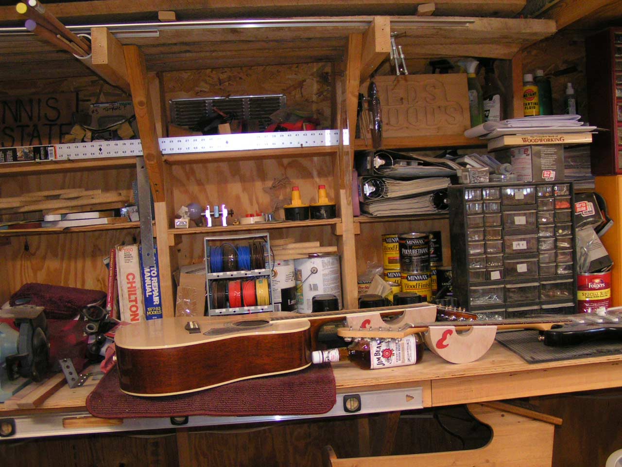

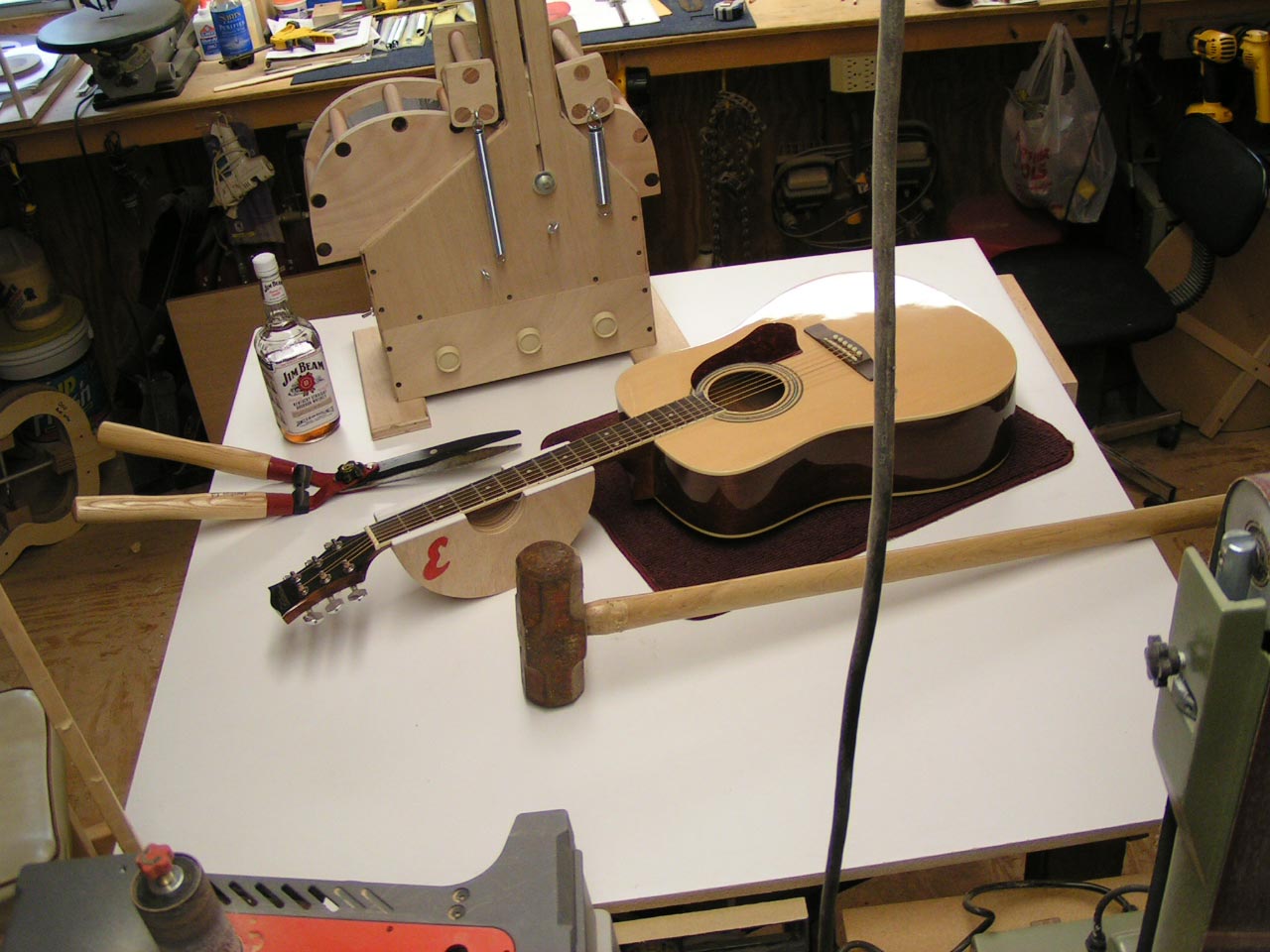

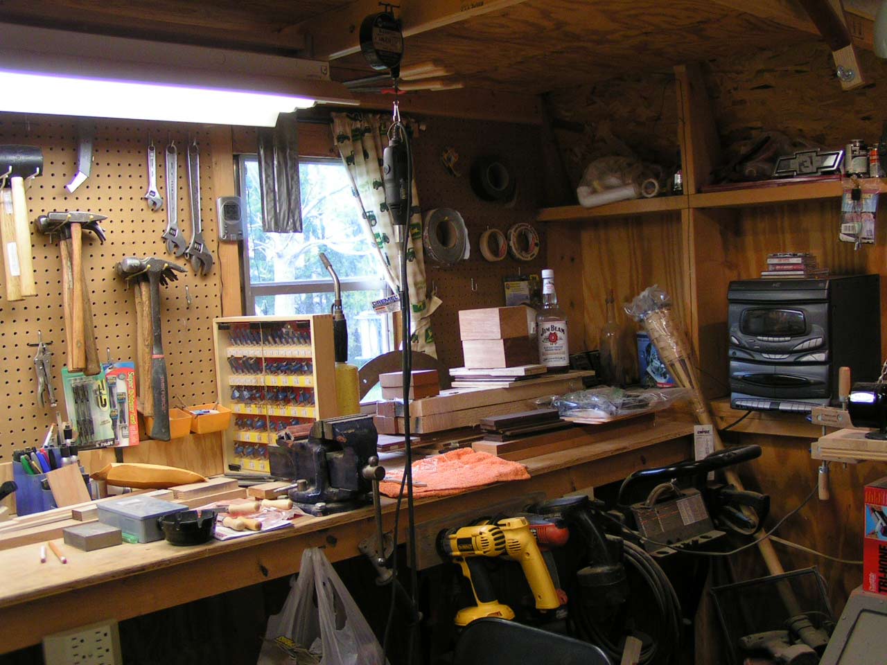

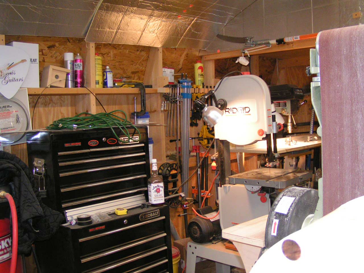

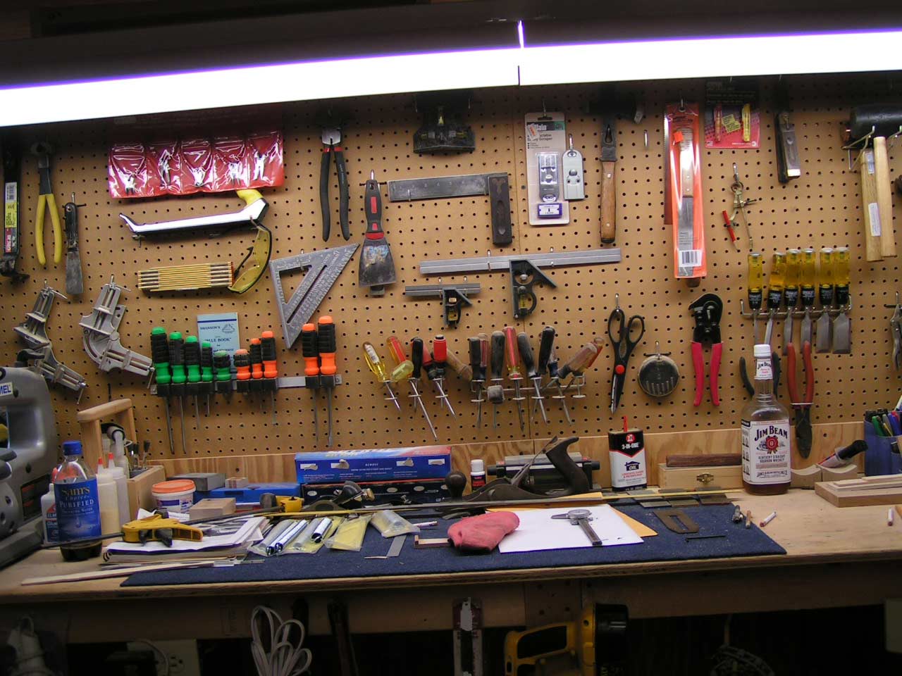

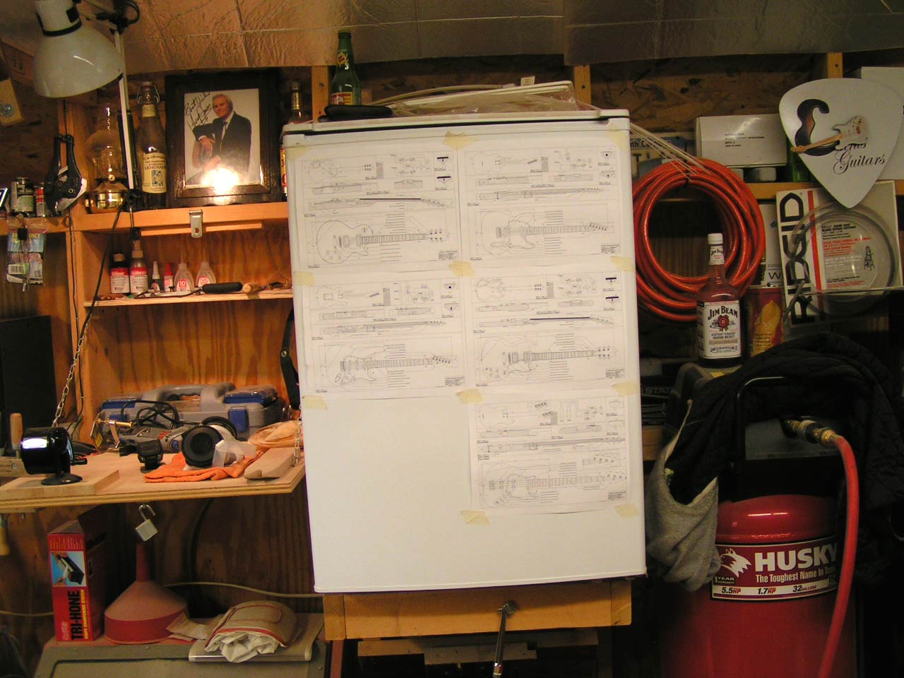

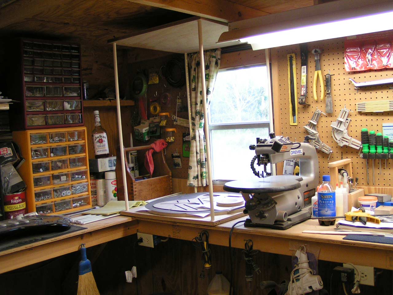

just a few pics of my dads wood shop
maybe you could use these as far as placement of things
(wheres jimbo?)

Yikes! I'd get bummed out in that shop. Needs to be brighter, friendlier, more open. Needs paint.
explains the bottle in every shot <g>

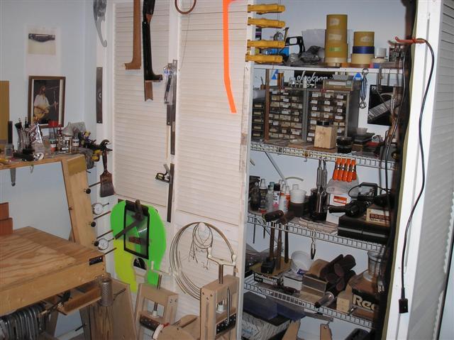

Here are a couple of images of my workspaces. Please try to overlook the mess. I've been busy and it's been a couple weeks since I've done any tidying out here.
The first one is a three-shot panorama of the inside of my shop. It's so small, I can't even stand outside the door and get a complete shot of everything. I have relegated all of my dust-making tools to my covered patio. The only one that has a dedicated collection system is my drum sander -- a Rigid shop-vac located under the sander's table.
My shop is wide enough (9ft) where I was able to build two benches, one on each long wall. I have built some shelving below the benches and I store a lot of other stuff under them as well. Almost every square inch of my walls is dedicated to shelves or tool racks. Build as many shelves as you can fit into your shop. They'll get used, believe me.
I also built a table on locking casters -- can't see it -- it's buried under stuff at the left of the image (look for the neck blanks). When I first began building guitars, I used it a lot, and found the ability to roll it around the shop (for use or for moving it out of the way) very useful.
I located my Parrot vise on the outside corner of the bench on the right (not visible in the photo), which maximizes its effectiveness when clamping long things like necks or even guitars in progress.
One of these days, I'm gonna get my garage organized, and I'll move the lathe out there. I could really use the three feet of bench space it's currently occupying.
Also, if you look closely just behind the light colored chair, you'll see a slab of Corian that was a sink cutout from somebody's kitchen remodeling job, laying on the workbench. I use this a lot because there are many times I need a very flat surface. I can highly recommend picking up something like this. If you can find a sink cutout, the best part of it is that it is usually free. The remodelers around here just throw them away.
You'll also note the two round adjustable lamps. These are the ones with the fluorescents and magnifiers. Even though lighting is good in my shop, there are times that the added light that these provide is essential. Nice thing about them is that they are easily moved. I also have four outlet strips attached to the bench risers, and all get used.

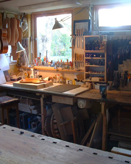

PostPosted: Sun Jun 04, 2006 4:32 am
First of all, congrats on the new aquisition Mattia!
First you should make a list of every tool, clamp, wood shelf EVERYTHING that you plan to put in that shop. Measure your band saw and dust collector and other large items and start putting everything down own paper (or your favorite cad program, paper cut-outs of tools and benches, scale model, whatever) to see how, or IF everything fits together. Then: Kill your darlings! If that drum sander (or whatever) is just too large for the room it will have to wait for the next shop. I would hate to have to trip over that sander ever time I turned around! With a shop that small I would rely on hand tools for the most part.

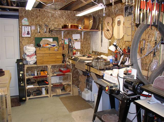

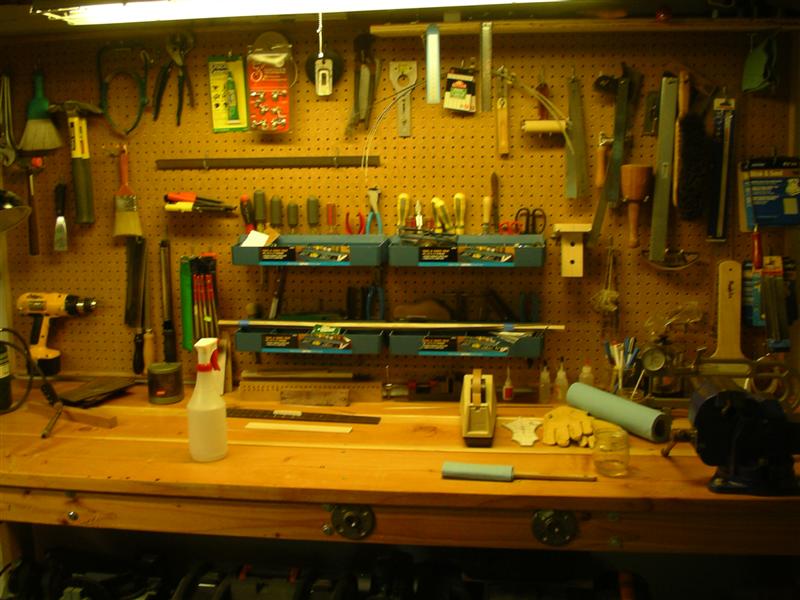

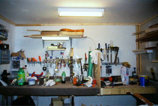

Here is an old picture of my main work / hand tool area:

Who knew Jim Beam had so many use in the shop.

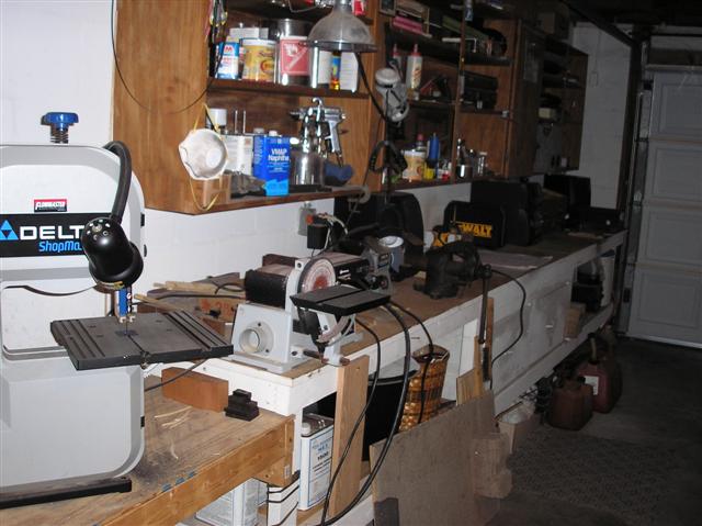

PostPosted: Sun Jun 04, 2006 9:50 am
Mattia,

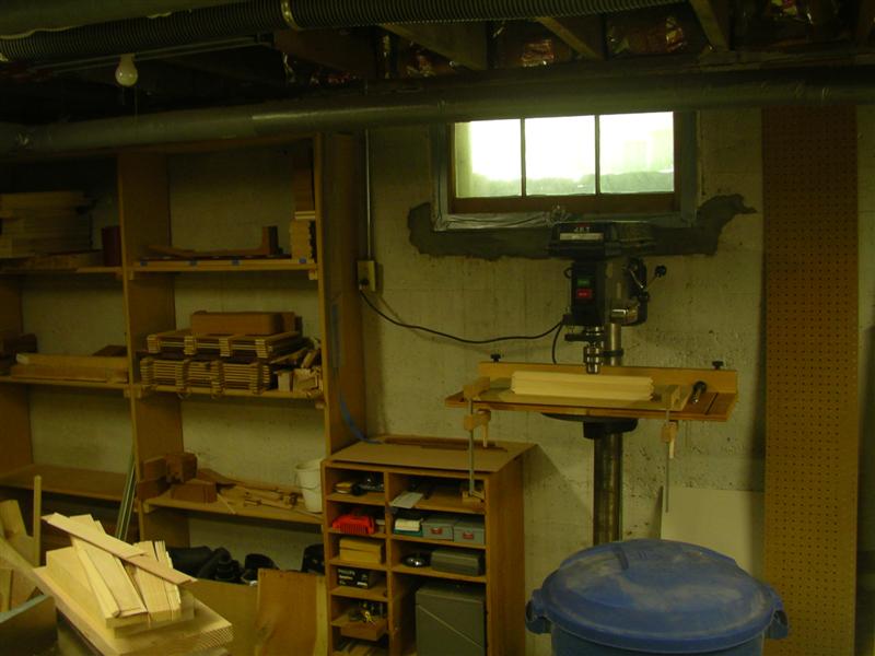

   My shop is kind of split into two areas.It's half in my garage and half in a small room.The problem I have is they are at separate ends of the house so I'm walking back and forth. We don't have basements here in Florida. I am considering building an add on next to the garage.
I use a nearby closet for storage
The garage

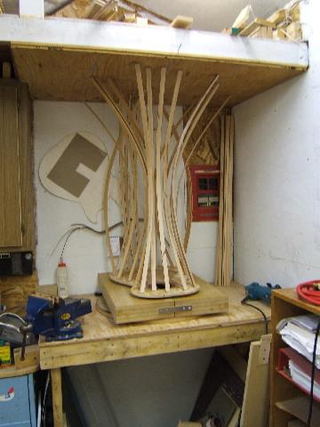

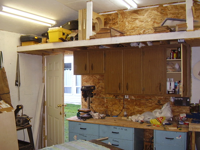

LOFT, LOFT, LOFT, makes for lots of wood storage, and jigs as well.
And use the underside of the loft as the top of the go-bar deck
That's my two bits

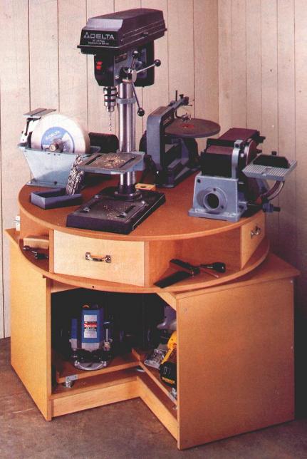

Mattia, I saw this revolving work station in a publication called "The Complete Small Shop" that I thought would be a space saving item. I haven't built one yet, but will when I get some of my other projects caught up.
Good luck on getting your New Shop set up. I know you are going to enjoy it no matter the size.
PostPosted: Sun Jun 04, 2006 3:07 pm
D.L. that's a great way to make use of a corner. I saw a variation that had the rotating part set flush into the top surfaces the two intersecting workbenches. A big spinning inlay!

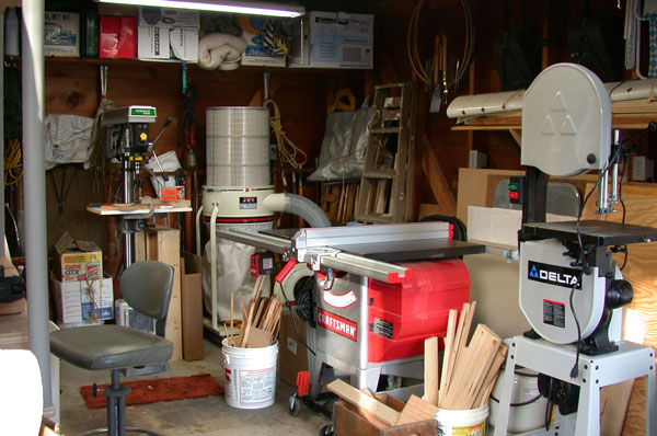

Here's my machine corner in a slightly oversized one-car garage, 9 ft by 18 ft. I stay pretty much out of the last 7 feet or so of the length, for the kids' bikes, scooters, and such, so it's more like 9 x 11. Rather than scoot the DC around to each machine, I stuck it in the corner, which is normally pretty awkward to use well. It stays put, as does the DP, which is bolted down for safety reasons. The TS is closest to the DC to keep the DC hose run short, as it produces the most dust, until I get my thickness sander built, that is. The TS is on a roller base, since I sometimes have to move it to cut larger stock. The BS also rolls; it's moved out from behind the TS rail for each use. It's light and moves easily. The thickness sander is going to be on wheels and live under the DP table.
Don't forget to put in more power than you think you'll ever need. It adds up quickly.

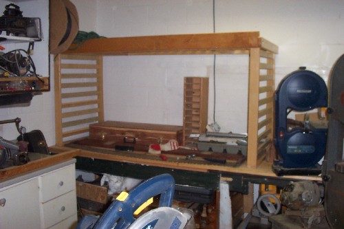

Hi Mattia, an old futton base can make awesome upper storage for molds and other jigs, like i did here. My shop is 12' x 21'
You might want to consider putting your workbench on wheels like i did so you can work outside in the sunny days!

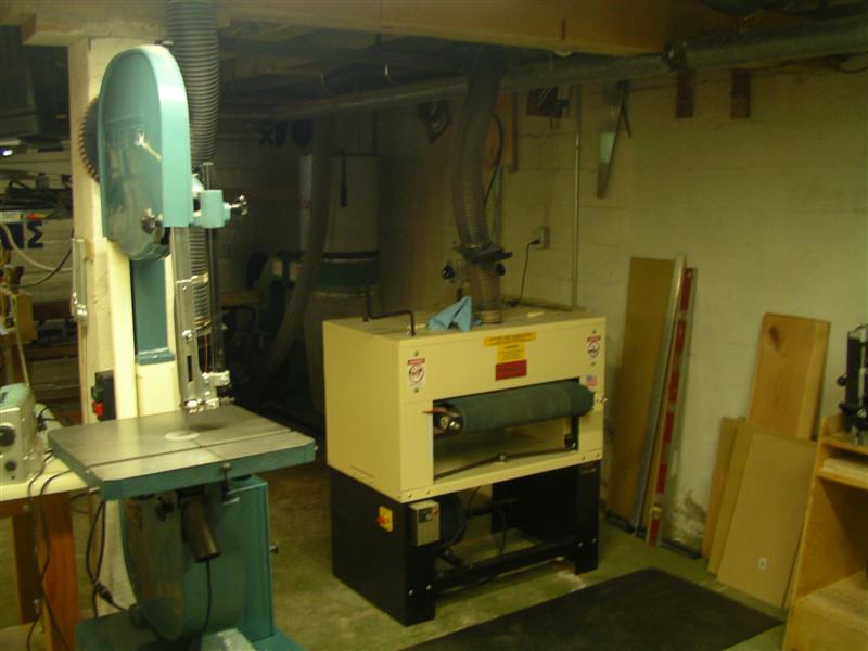

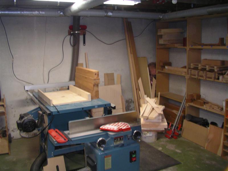

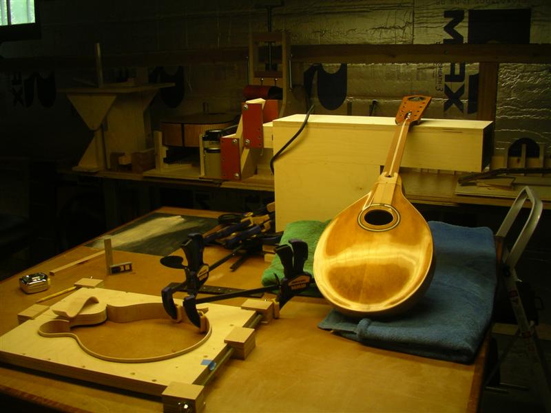

Okie Doky - Here's mine - In a basement with very little natural light, but it works!
Tablesaw and Jointer:

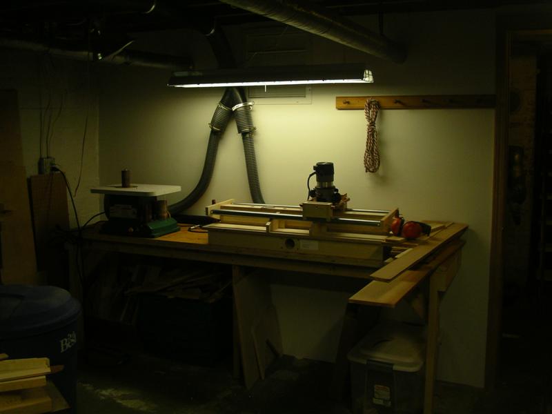

Radius Jig and Spindle Sander:
Drill Press and a little bit O' wood:
Workbench:
Bandsaw and Drum Sander:
More workspace:
And more...
And still more workspace:
Mandolins:
